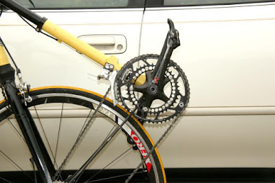

Antony Galvan's bike fitted with RotorRings Q-Rings. Antony is California State Criterion Champion (2009)
