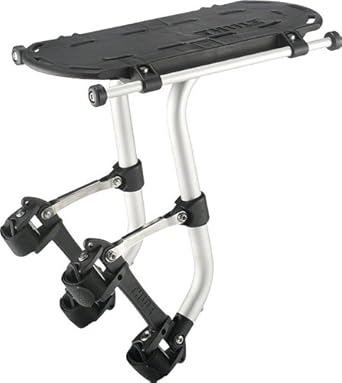

Charles, I can see the top
Charles, I can see the top clamps on those racks maybe attaching to the headrest posts, but I cannot imagine where the lower supports could attach. Even if the geometry allowed these to attach to the rear wheel or seat stays (doesn't look likely), that would bridge the rear suspension which seems like a no-no.
I've done exactly that (bridging the suspension) on my Sofrider with my rack and I do recommend against doing that (I've undone it on my bike).
I'm imagining bending the upper arms down so they also attach to the seat stays (it comes with p-clamps).
For the lower arms, I would want to mount them as close to the axle as possible. If you have a rear disc brake, I can imagine mounting the rack slightly differently near the bottom on the right and left sides.
It is possible the other rack would work better.
My offer to mount a rack on any Silvio that gets sent to me stands. If you don't want to send me a Silvio, then at least taking close up pictures from both sides of the rear stays would help. :D

I don't think that the top
I don't think that the top clamp arms of Charles' first find would need to be bent to attach to the seat stays. Here's why: This low res pic I found appears to be same rack. It looks very suitable as it can be positioned further back and be adjusted so it's horizontal.
mAbFBkH0TdUmrrtC_M2Xxpg.jpg height:376px;
Charles' most recent find can't be adjusted for the angle so I think the first one is better.
Tuloose, my offer is better - just send me a rack and I'll reply back with tons of photos! :)
Hi Ivan,
Nice find on the
Hi Ivan,
Nice find on the picture. Notice that the bottom supports of the rack are done differently on the disc brake side and the other side.
Does look promising.
Cheers,
Charles
Cool, looks like those arms
Cool, looks like those arms are designed to bend and extend. The next question in my mind is, how much clearance will you get between the rack and seat back? I guess if the goal is to hang bags off the sides of the rack, you don't need much.
