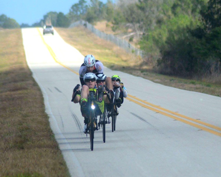

Cool photo of the lead pack fighting the headwind on the second half of the 100-mile race.
That's Jesse Groves pulling at the front, Kyle Larsen, and Larry Oslund on Cruzbike V20s. Jean-Luc Perez is tucked in the group on his standard bike and will go on to win the 24-hour drafting race with 463.9 miles. Great photo shows just how much of the standard rider is sheltered from the wind when they are tucked. I'd estimate about 66%.
Awesome photo. 66% is right on the money for my 6'3'' frame. 0.290 CdA on road bike (bars, good kit, good wheels) vs 0.195 CdA and 145 watts vs 210 watts to go 22 mph. 66% less flipped around is 50% more.

Interesting profile pic. Three blazingly fast riders, each with a slightly different frontal exposure. Unless there is an optical illusion, it looks like 1st Larry's body position is the most horizontal and I assume most aero, 2nd Jesse's position looks to be the most vertical with the most frontal area exposed (less aero?) and 3rd Barefoot's looks intermediate between the two. If you could share - what seats and approximate angles do each of you ride?

I am just riding the stock V20 seat. I have a lumbar piece in it but that should not affect my seat angle.
I think Kyle is also riding stock seat, but because he is taller, his head is up higher due to headrest going higher. Although it does look like his chest is at a steeper angle than mine.
I am pretty sure Jesse has a Thor seat mounted but not sure what the angle is. Steeper angle means ability to make more power, but your position is less areo. Probably ends up cancelling out to a greater extent.

Bottom line: three awesome motors running together right there. Kudos to you all!

The thing about that photo is a slight illusion created by the head-on perspective. The riders closest to the camera seem larger in relation to the riders further back and this makes the last rider (DF) look like he's lower to the ground than he might be in actuality, due to his distance and apparent relative size. A side pic would reveal more accurate frontal area differences, and it might be more than what is appears for the DF in spite of his lowered TT position.

I have the Thor seat with ADEM headrest set up per the instructions Ratz wrote up, but I am not sure what angle of recline that gives. It basically follows the curve of the frame, but because the shoulder area curves up it pushes the upper body and head higher into the wind.
Cruzbike posted a side profile photo on Facebook of Larry, Kyle and I going through the last turn of the race; that photo has a fence in the background that gives a good horizon to compare our positions on the bike; in it, you can see that my head is about 6" higher than Larry and Kyle riding the stock configuration. It really shows the difference in setup better than the head-on photo.
The Vendetta with Thor seat is without a doubt less aero than stock, and for me, about .5 to 1 mph slower at 200w. I make the same power on the stock seat as with the Thor seat; which GASP...is the same power I made on the Schlitter (at 12 degree recline); basically, the angle of recline has little to no impact on my power-to-heart-rate ratio. It also appears that RWD vs FWD has no impact on MY ability to make power either; at least, that holds true for everything except sprinting...I have better max power on the RWD as opposed to FWD (that is not a typo); my max power on the Schlitter was close to 1000w and on the Vendetta is close to 800w. Hopefully, my max will improve on the Vendetta over time; I have had to DRASTICALLY change my pedal stroke as I was unable to keep traction on the V whenever I would sprint; I could break the wheel lose at will using the pedal stroke I developed on the RWD. It was apparently not a very even stroke and my torque would hit a huge spike in power in one particular phase of the stroke. If any of you ride with DF groups, you have probably heard the torque sound (WOOSH, WOOsh, Woosh, woosh, woo...) a tire makes when some riders start their sprint; I could make that sound on the Schlitter but not on the Vendetta; instead, the wheel spins out for that brief second.
Also of importance is the length of the chainstay because it effects how high your feet and knees go. If you look at the photo of the last turn, you will see that Larry has the shortest chainstay (even speaking relatively) and I think increases his aerodynamics a little bit. I have the 23" chainstay and am in discussions with Robert Holler about whether I should switch to the 21" or 19.5" chainstay. The last I heard from him was that it is best if the knees do not go higher than the shoulder; however, I believe I have seen Ratz post that the knees should not go higher than the head. Any input on head vs shoulder height in that regard would be appreciated.
I think you will be more aero if you adjust your chainstay to keep your knees at their top no higher than your shoulders. Putting a 650 wheel on the back may also help you some. :)
I hadn't thought of putting a smaller wheel on the back, but I guess that would effectively increase my angle of recline. Good advice Larry, now for the tough question: How do I convince my wife that I need another carbon wheel? :)

I actually tried the 650 myself, but it put me down so low that my visor and helmet were catching more air and the visibility was also a little worse. I appear to be in almost perfect location with everything stock. One of few times in my life that being short has a good benefit. I would look around for an inexpensive used 650 - maybe Zipp 404 and put some wheel covers on it. You still in Asheville?
