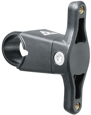

The Topeak CageMount offers a
prod74876_Black_NE_01
The Topeak CageMount offers a more secure system that is not based on velcro like the Biologic. I have used the Topeak CageMount successfully on my Brompton for a long time. It would fit the Silvio boom.
http://www.topeak.com/products/bottle-cages/cagemount
The Topeak unit as usual is
The Topeak unit as usual is nicely made and is a permanent fixing. The velcro one puts the bottle close to the boom.
