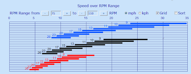

But it's on a 20" wheel. It's morally equivalent to a 36T on a 700c wheel. You can see my gearing here. (I've got a 48/38/22 matched to a 11-32 on my 26" Sofrider. The gearing is a little bit broader than my Cruzgami Mantis).
BTW. This gear calculator is very cool. Hunted it down and set up my bike in it. Very straight forward and useful. Thanks for sharing.
