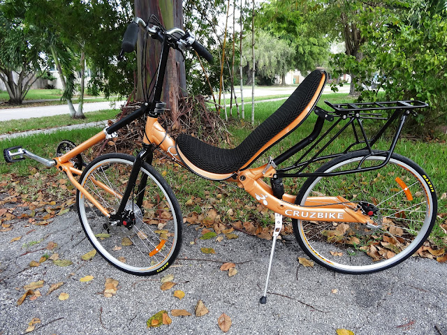

alrighty then, here's another new Cruz customer :)
first this...
and now this (afta asstd mechanical mayhem)...
now it's time to learn how to ride it, fine tune it, tweek it, & buy stuff for it! Wish me luck... :D
The bike and especially the rack looks GREAT!!!

So here's the latest post-farkle pic. Added a puter, bottle racks, spd pedals (won't clip-in for awhile), tube/parts bag, tailite bracket, pumpy, & big ole luggage sack :cool:
