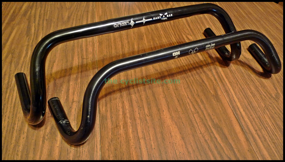

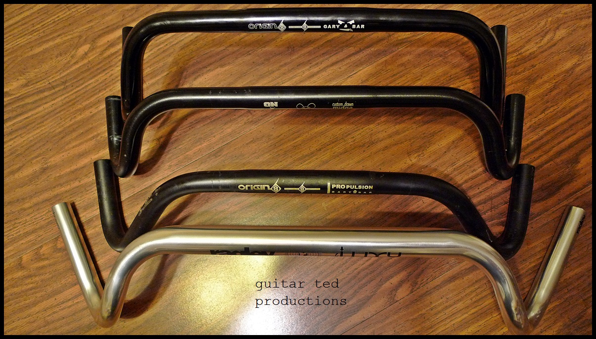

comparison photos
My preferred handlebar for the Vendetta is the Gary bar from Origin-8 with 5 to 6 cm sawed off the ends and filed down smoothly.
The 31.8mm clamp version of this bar has gotten very hard to find. I like it for the extra reach (I prefer arms more stretched out) and the knee room. Here are some photos for comparison.

Jim that is a stunning picture comparison, that Origin bar is much more what I would have expected with the bike, this project might not have started if those had been the bars as they look like they would not have had the wrist problem that started me down this path.

What about the On-One Midge Bar?
I found some pictures of original WTB, new WTB and a Midge on the mtb forums and thought it would be interesing for those looking for alternat bars. The Midge Bar seems closer in resemblance the Origin 8 bars and is in production in both 25.4 and 31.8 clamp diameters:
(On-One Midge Bar Link)
More comparisons Here and a more detailed one Here.
