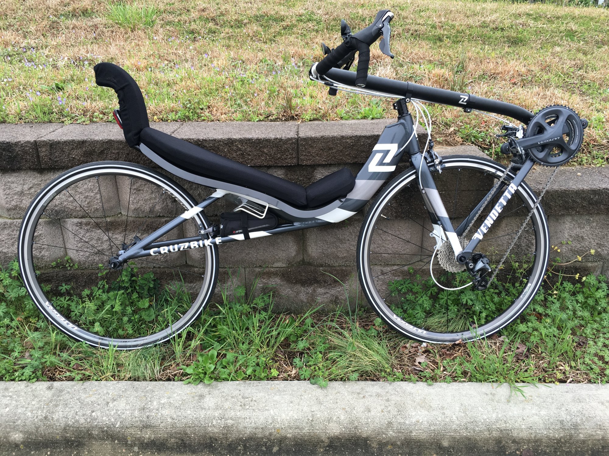

Finally all put together. I rode awhile with no handlebar tape so no pics until now.
Ultegra 6800 group set
50/34 front, 11/32 rear (bottom?)
165mm cranks
Ultegra wheel set
The wheels aren't the best but I got them for $300 and they're tubeless ready.
I'm getting much better at the slow speed stuff. Took her out on the road to do some hills today. Downhill was scary. Steering is so twitchy you have to be really careful not to overreact. I hope in time it gets easier to handle at speed.

Like everything else; relax and practice. Going down hill is all about a low center of gravity and relaxing. Since you can't put your weight on your feet it's hard to load downward. True of any recumbent.
So on your first hills, focus on putting your weight on you sit bones, let you thigh go heavy as you can; and relax your shoulders. Be deadman heavy like if you are trying to mess with someone trying to carry you. Then coast. It should pretty much look like this video of going 35mph down hill coasting. Much of this video was one handed (itchy nose if I recall correctly).
It you tense up; it does get twitchy; but that's the rider not the bike. The other veterans will confirm that. As you advance you can also go to more narrow handlebars which in turn reduces your leverage and makes it harder to over-correct. The wide handle bars a good for beginners, opinions vary as to whether they are good once you figure it all out.

Nice bike! I have the same wheel set; great value! Your tires look quite thin so I guess you pumped them up really high? You might find with 28mm you get a more enjoyable ride.
Couldn't quite see the pedals but in the beginning stages I would not want to clip in.
You might prefer to put a cushion on the headrest to bring you further upright whilst you get the hang of it.
They are Continental GP 4000 IIs, 25c. I have tubes in them but will be going tubeless soon. I run them at 90 psi. The ride isn't bad.
