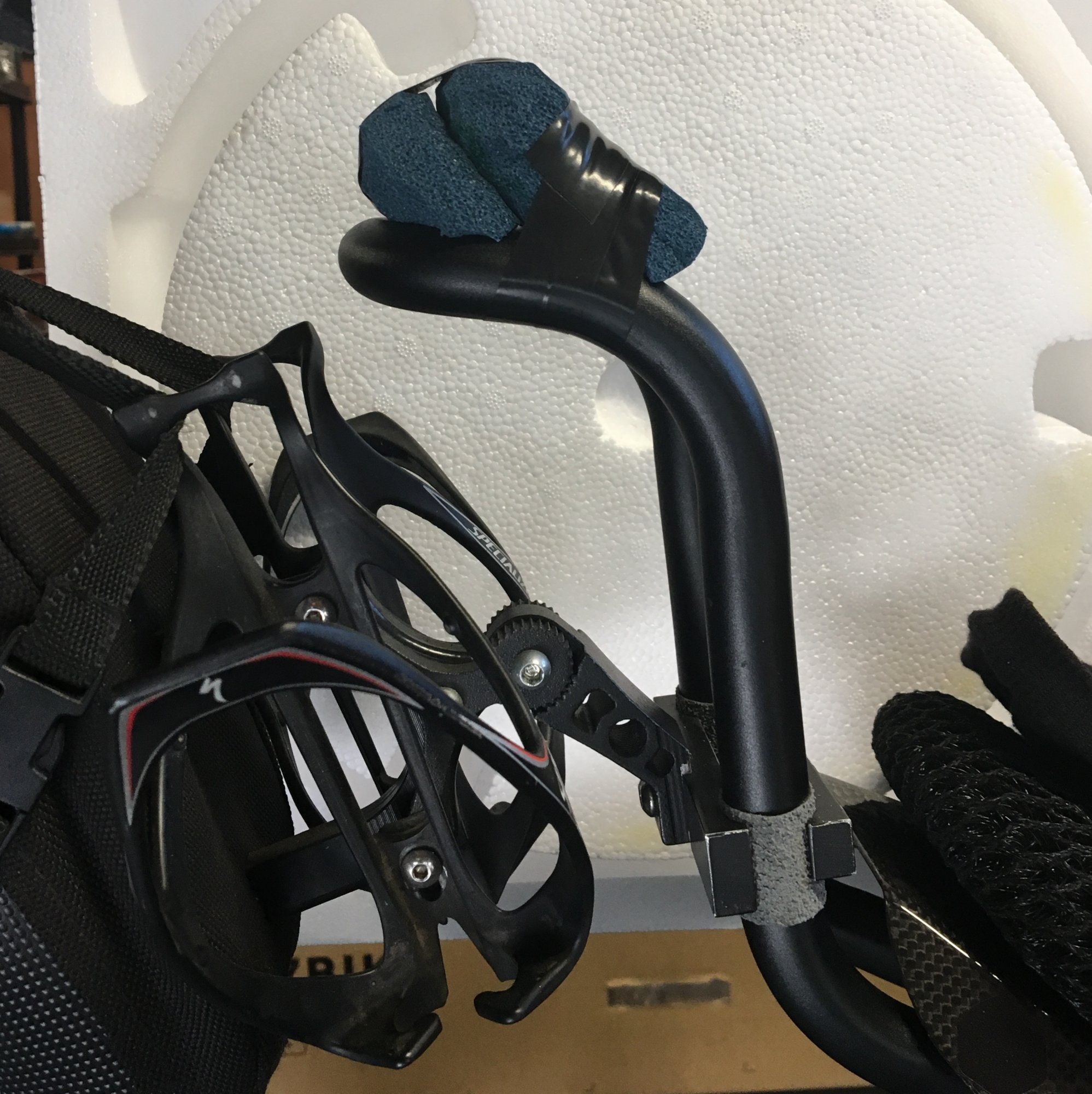

Hey - I taped some padding to the top of my headrest like this...I also needed my head a little more vertical and I didn’t like my lower neck coming in contact with the base of the headrest.

Leif: That foam looks like a good cheap solution. I keep making different foam shapes looking for the right way to nudge my skull up and forward. I will keep trying...

1) Foam block on top of head rest to change head angle

I'm still staring at the sky! This photo from today's ride is with the boom in. I tried a foam block to prop my head up. The position was great for seeing the road but it hurt like hell. Just a few degrees forward toward vertical solves alot of my issues with this bike. Now I just have to find a way to achieve that position comfortably supported.
