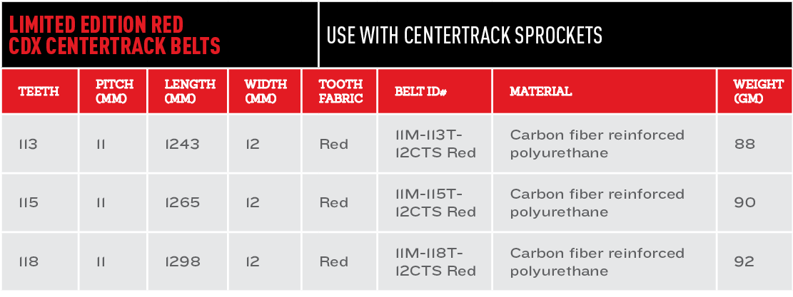

Here are some belt sizes:
TEETH LENGTH(MM)
108 1188
111 1221
113 1243
115 1265
118 1298
120 1320
122 1342
125 1375
132 1452
