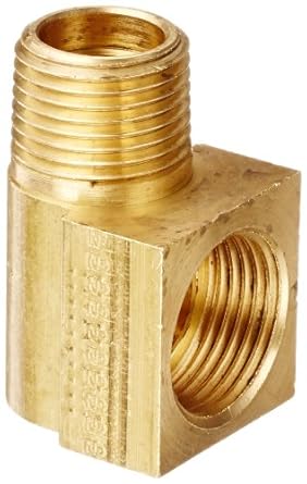

https://www.blackwoods.com.au/part/03304703/elbow-brass-mandf-hw-bspt-18-6mm
a 90 degree m/f brass elbow of the correct thread size and type should fix this problem, as long as the elbow height is not too high?
bret
No. Forget about the rack, consider taking the shock out and attempting to replace the valve with the part you show. Look at the distance between the part that is screwed into the shock itself, vs the height of the fitting you show - the proportions on any I buy would be similar.
There will not be clearance to rotate the brass elbow itself around without hitting the shoulder of the shock - regardless if it could fit within the arms of the rack once installed. That is, as I attempt to screw the elbow into place, it will hit the shock - there's no way to screw it all the way down.
