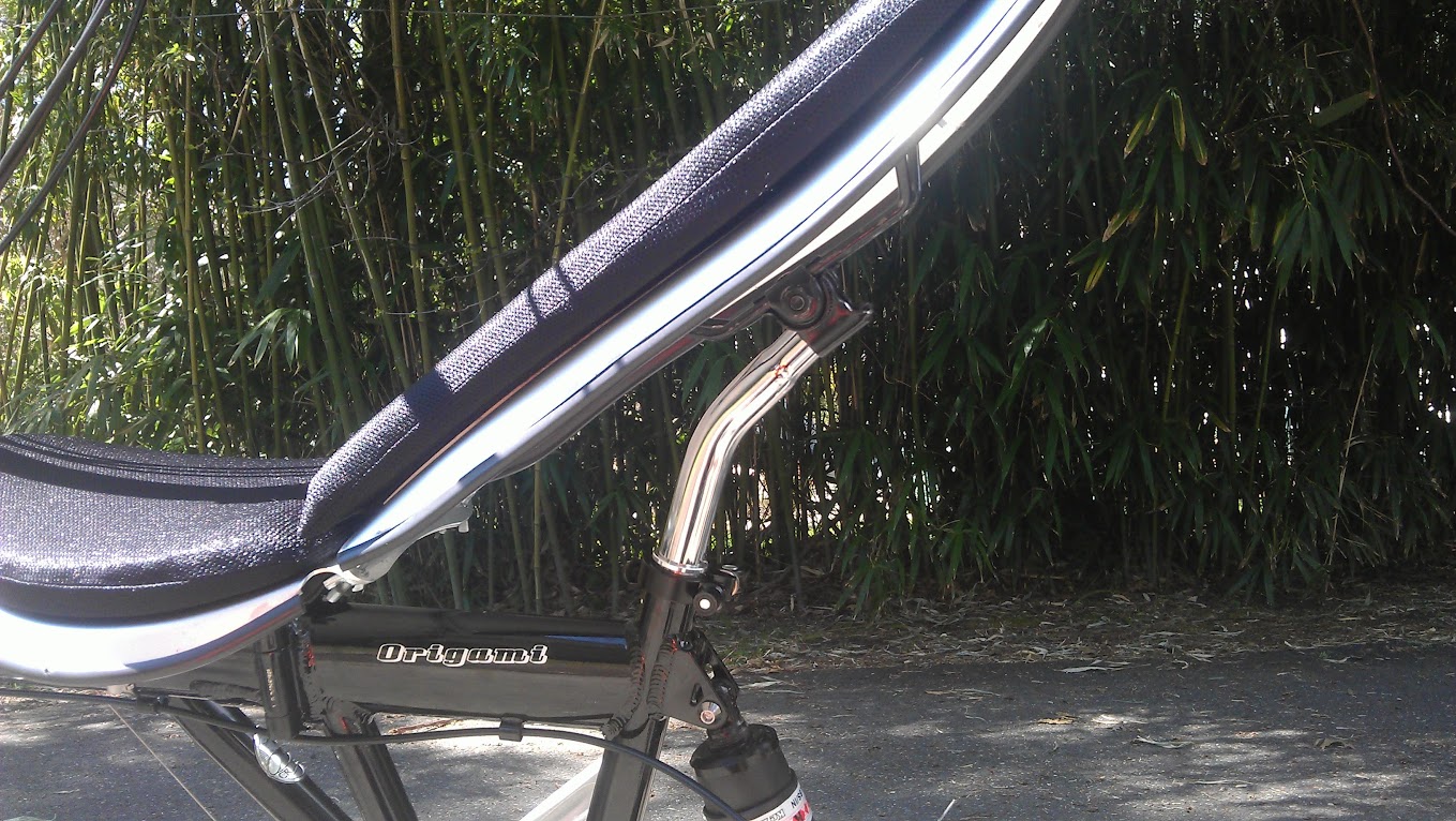

Let's try these pics again, this is as far as I can lean the seat back with my extensions, I think if I could, I'd move the whole seat back another 2 inches, and then lean the seat further back, but that will take some custom seat post arrangement. I have two aluminum spacers on the front seat pan mounting screws to tilt the seat pan up a little, about 10mm.
I stuffed the seats with foam and removed the flat hard foam panels inside, it feels cushier, I will try it soon. The Fox air shock is smoother the the spring setup, it does raise the frame about an inch, bit I'm back to level when I sit on it.
The Serfas Drifter 26 x 2.0 tires fit well and raise the whole thing a little, much smoother with lower pressures and great grip.
Thanks for all the input! Mark
Check out Charles
IMAG0749.jpg height:766px; width:1359px
Check out Charles Plager's layback seatpost on his Cruzigami in his blog here. Charles has some good photos of how much more his Cruzigami conversion seatback is able to be reclined with the layback seatpost he bought.

Nice bike! I really like the seat back extensions you created and the air shock upgrade.
After seeing your bike, it's
After seeing your bike, it's clear that you need to lower the seat angle. With it that upright, your gonna feel cramped.
I like your seat extension. Try and find a way to keep the extension while being able to lean the seat back much more. With both of my bikes, I can get an angle quite a bit lower than in the picture Eric posted.
And this may seem counter intuitive, but try moving your seat pan forward. The idea is to keep your center of mass where it is now, but spreading it out (my seat pan is as far forward as it can go).
And, as usual, Eric is right about foam that's too soft. Try putting soft foam on top of harder foam. (Although if you get the seat angled more, you'll find you don't need it as much).
I think you can get there. Good luck and keep us informed. I think these changes can really be there differences you need.
