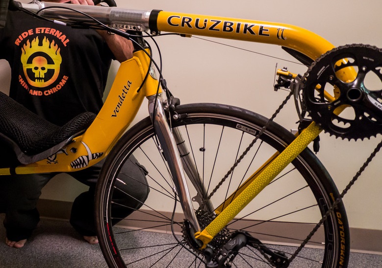

Ratz - You forgot one - maybe the most important one:
imho:
THE V2.X WITH AWSOME LOOKING BOOM - IS THE YELLOWIAT/COOLEST/FASTEST/MEANEST LOOKING OF ALL THE VENDETTA'S, PAST AND PRESENT!!!
... just saying!!!

That's why I kept it and I got the Shimano ultegra 11 speed groupset on it from day one. Awesome bike.
