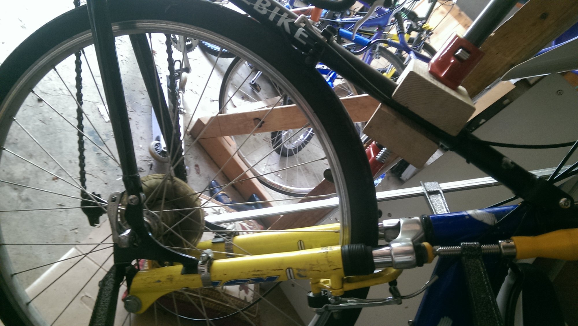

Here's a photo. I used bar clamps to compress the shocks until the front downtube hits the wheel. That happens after about 1.75" of compression, so the shocks still have a fair bit of travel left in them beyond this point.
UPDATE: image is now public. It should be self-evident that the fork is turned around. The rim is a standard mountain bike 26" x 1.XX" (originally held 26" x 1.95" tires). Note also that the adjustable downtube is at maximum extension due to my height. I will post another picture of the whole bike.

BTW, You never did say what size rims you've got, nor comfirmed you turned the fork around.

Now it's obvious. Now that I think about it, the telescoping front tube (official name for the thing you're calling the downtube) hitting the tire is the ultimate limit on TFT extension on my bike too; the only time that happens is when I'm doing maintenance stuff to my bike, my normal extension is pretty short and I'd actually like it to be longer to improve the angle for the front derailleur.
I think you're going to have to try to find ways to reduce the extension, probably by moving the seat back or your position on the seat. A layback seat post might help you move backward on the seat--though you'll end up pretty reclined. More radically, you might need a larger framed bike with a longer top tube, also to reduce the TFT extension.

As SamP said, the best option is to move your seat backwards.
You could also try smaller wheels, but I don't like this approach.
A fork without suspension will solve the problem, but you might miss the front suspension.

In case you don't want to go without front suspension, another option is to get a suspension fork with 30 mm travel.

Before embarking on any bike surgery, I'd consider the proposition you are just too tall for that bike (unless you can find a way to move the seat pan aft - a lot).
If the frame won't permit enough seat location adjustment, is there any way to move the clamp at the steerer tube up at all? Like about three inches? Maybe with a steerer extension? That would have the possibly undesirable effect of lengthening the boom even more. If you are near the maximum now, forget I said anything.
-Dan
SamP
That's a good point Dan. Putting some 2-3 inches of spacers between the headset and the steerer extension tube might be enough--if the steerer tube on the fork has enough length.

Integrating some of the previous posts, I'd do this:
1. The bike fits you now. Measure the distance from where the upper and lower seat shells bolt together to the center of the bottom bracket axle.
2. Reduce the length of the adjustable front tube until the derailleur "chainstay angle" is between 60 & 70 degrees. Preferably 63 - 67 degrees, as this is what most front derailleurs are designed for.
3. Now see how far you have to move the seat back to regain the original seat-to-bottom bracket dimension. If it can't be done, your frame is too short. Life will get easier if you get a longer frame.
Be careful with spacers. You can run out of fork steerer tube length and the steering column tube can detach from the steerer tube if you're pulling hard up a hill.
