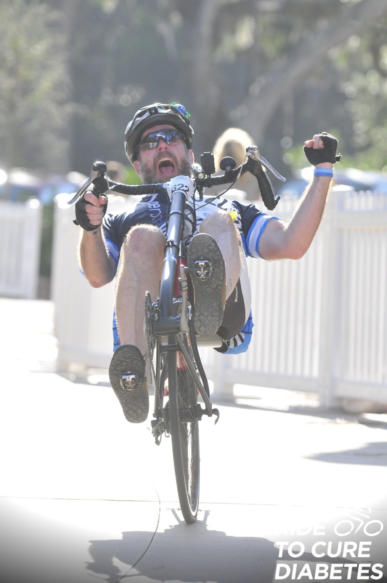

No problem on Clydesdales. I'm 6'2.5" and north of 275 lbs. I've been riding my Vendetta, Sigrditha, since spring 2015. It's the best bike I've ever used.
I'm using moderately priced components a buddy and I cobbled together and the standard sized chain stay. I've got a straight handlebar mounting tube rather than the curved model. Works great.

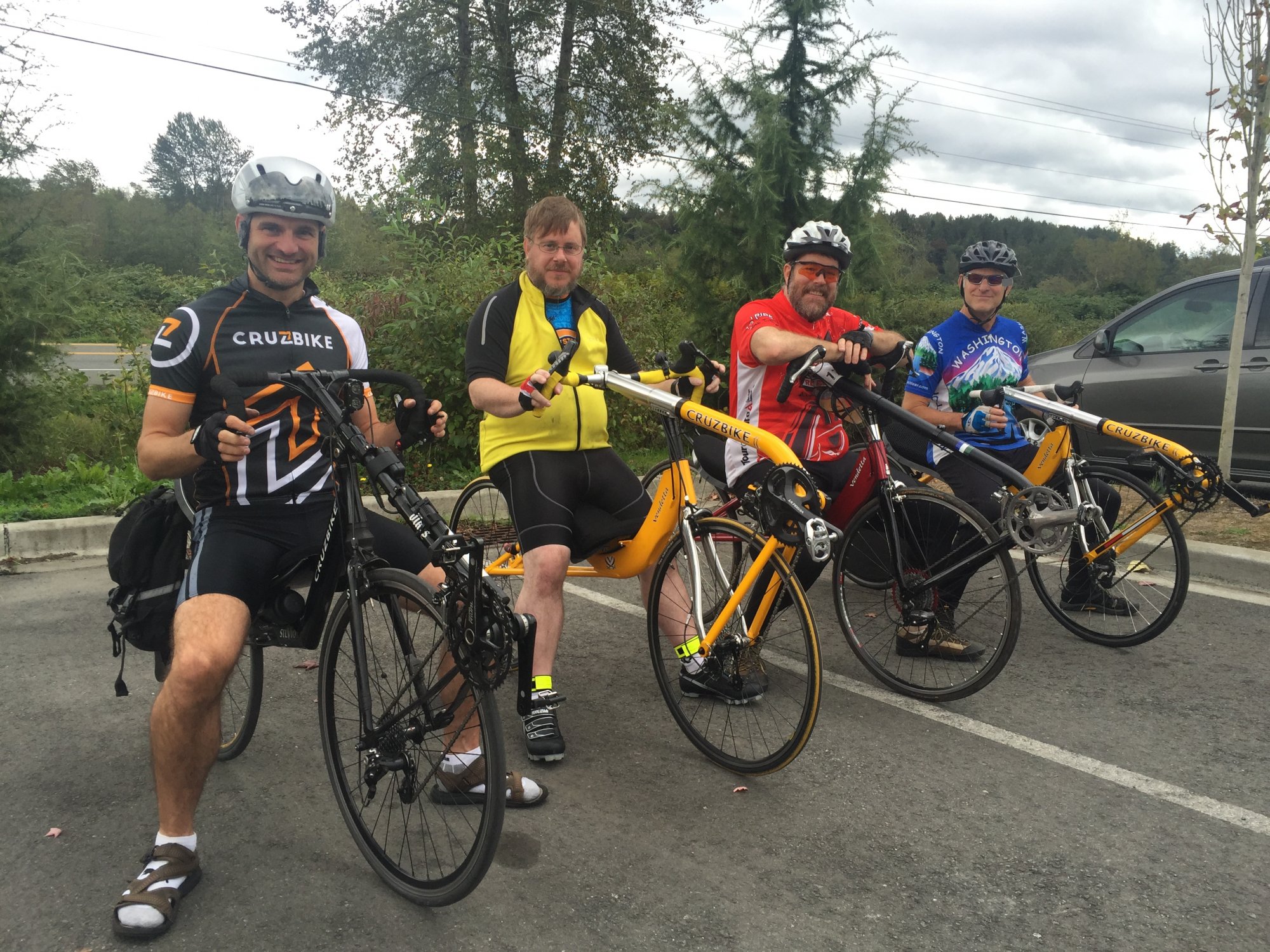

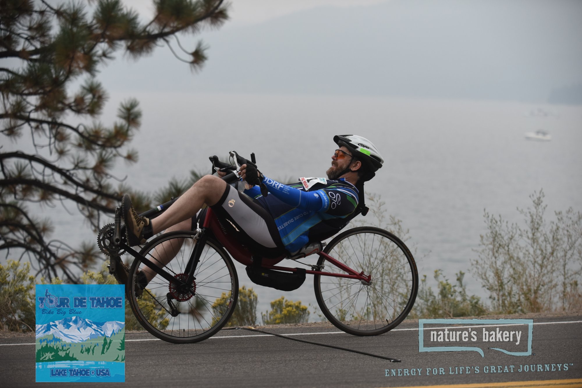

Here are a couple more pictures that might help with scale and fit. IMG_0004.JPGMe next to Maria. IMG_2493.JPGAnother rider on SigrD. Note he cannot reach the pedals. IMG_2494.JPG IMG_2495.JPG

I think Abbott forgot to mention that he uses a stern riser as do several others.
Makes the steer tube taller which raises the boom and that handle bars.
ccooper
Do you mean a "stem riser"?
Perhaps I should look into that. With an X-seam of 47.5", I find on my Silvio S30 that I have to bring the handlebars back toward my chest in order that my knees won't hit the bars. That leaves me with very bent elbows, which are probably not very aero. If I could raise the stem, it might help. I do have the long chainstays.
Bob meant to say "Stem riser". It's the silver doohickie in this picture between the handlebars and fork just above the frame. It raises the angle of the boom and provides more clearnce under the handlebars .IMG_2558.JPG
